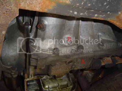

Need help. Bizzy i know you know the answer. But im sure someone else does to. I am following the directions on shotime to add a transmission drain plug. But where exactly do I drill the hole. It sounds to me like there asking me to drill it where I have the pic marked A. But that to me seems liek the bell houseing. (never did tranny work on these). Looks to me like spot marked B might be a good spot. But whats behind it? Could someone mark the spot on the pic for me and repost it so i dont drill into a gear or something. THank you.

NO never seen that. But A was close. Just the next section over closer to the shift linkage. But I now have another question. Right there next to where you drill is where the two casting bolt together. Are those both sides of same cavity in the tranny. And if so. Is there a "bell housing"?

Yes, they are in the same sump. The bell housing is where the clutch is...
