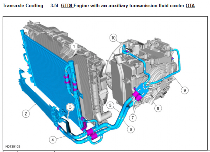

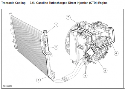

So no separate transmission oil to air cooling, just through the radiator is why I ask.
Sent from my SM-T860 using Tapatalk
All transmission cooling is oil to air. No connection to the radiator. Regular SHO has one cooler at the top of the A/C condenser, PP and PI have two, one on the condenser and one in front of the condenser.
