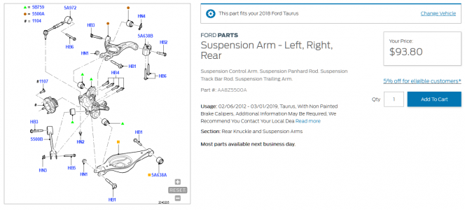

"Track bar" is what it's called on Tasca, 5500B in the attached pic. The weld at the round end looks like it failed, the bar dropped into the pavement and broke off.

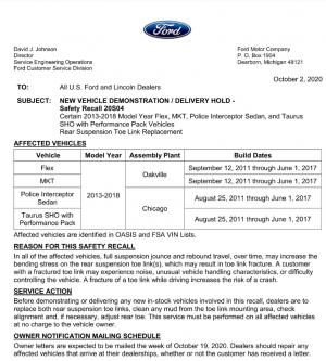

Its called a Trailing Arm. I've not heard of those breaking before. I know the Rear Toe Link has and as was mentioned, there's recalls for the toe link.
As for the trailing arm, Steeda makes upgraded ones for the Explorer, I wonder if it fits on the SHO.

Ive never heard of the trailing arm breaking. Now you worry me, something else to add to the list.
I replaced the toe links.

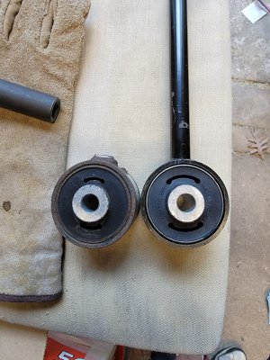

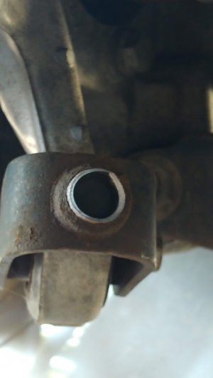

Hey everyone... sorry for the delay in reporting back. Still thinking things through. Turns out, the trailing arm I got from the Ford dealer has the wrong bushing in it, compared to what came on my car. In a few hours, I will have what I think is the correct one from Tasca coming in the mail. But that's not what we're really on about here...

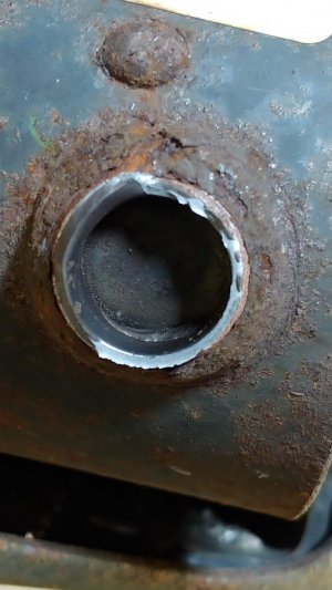

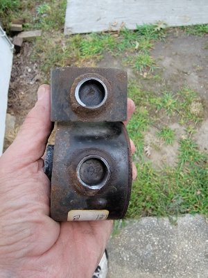

The failure itself, here are pictures. Very weird, that both ends broke like this. I've ran the entire thing through my head, and I believe what I ran over was a 6-8" piece of black pipe. There are marks on the subframe that look like pipe threads.
Here are pics of the failed ends, and the new arm vs old.
New arm is AA5Z-5500-A which is what the Ford dealer said should be the part, based on VIN.
The old arm is I believe AA8Z-5500-A - note the "8" - this 8 is in the label on the round end bushing, and on the bushing itself, while the bushing on the new arm is a "5" in the same place.
Also note the difference in the bushing. Again, I have the AA8Z on the way from Tasca, and according to pics I've seen, the bushing is correct.

That is very scary, sorry to see it, nice pictures for us to inspect on our own.
BradM
Dec 22, 2022
377
339
60010
Wow. The welds didn't break but the metal did. You should see marks on the broken arm itself. It had to have taken a direct hit for it to break like that.
krewat
Dec 20, 2012
1,191
1,025
Long Island
The arm itself is gone. It completely disappeared. At first, I thought, well, the front weld broke and the arm dropped down into the pavement and broke off the back. Nope, that rear bushing is stiff and no way that went down into the pavement first.
It's like hitting the stem of a wine glass, and the two ends of it break and leave the base and the bowl ...
Is it my imagination, or insanity, that makes me think the welds penetrated TOO far and the bar was weak right next to the weld? There is no rust intrusion that I can see. I'll get better pictures of the breaks.
