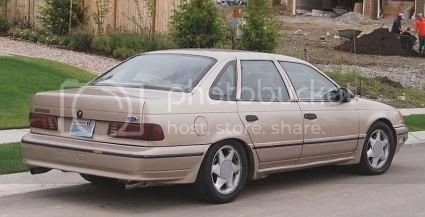

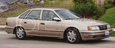

SHO Continental said:
a pic I like to show.. this is on uncut intrax with original struts.
here's a newer pic.. :biggrin:
WOW :dribble: THAT THING IS A CLEAN A$$ CAR!!!!! I wish my car was that clean!!
