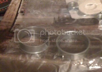

The short bodies are from mid 92 to 95. The spacers are needed for the short bodies. The ones they list are short bodies.

Are these the spacers you were referring to?
Spacers
They came with my rears and are about the dia of the shock tube.
