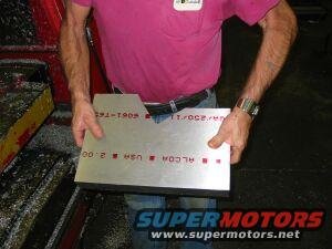

But if you ARE worried AND you want some bling, serious bling then you want one of my custom machined, from a solid block of aluminum, upper timing cover. It has an o-ring and groove to fit snugly against the backing plate. I only have six left. They have YAMAHA machined into the outward facing surface, and of course they are polished.

Mmmm, shiny.
On an older thread, someone mentioned the aluminum cover would only fit on a 3.2. If that's true, do you know why?
Each time I see that picture I fantasize about one of those bad boys under the hood.

Mmmm, shiny.
Each time I see that picture I picture one of those bad boys under the hood.
That is correct. They only fit the 3.2 engine.
