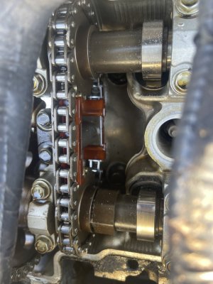

It’s the front one making noise so lucky it’s easy to pull up i will do thay next week and up date with pics see what you guys think

Update !

Check the cylinder and see if there is any damage. If not maybe cam or head swap can save it. Anything that involves keeping this car requires a cam weld going forward. This happens alot and people come on here like nah... won't happen to mine. It is a flaw of all of them

Yea that’s how my white one was but this time im not going to keep running the car I can save this car for the meantime it’s going to sit till spring
