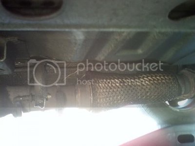

Think I found my exhaust leak

Where do you get a decent one of these new? I've heard stories of people getting the wrong ones, I don't wanna end up choking the engine or anything.

Exhaust shops buy these in batches , generic flex's.
Under 120$ installed would be good.

Is that flex pipe absolutely necessary?
It's a good idea unless you have pretty damn solid mounts. When the engine torques front and back it will bend at that ****** and w/o a flex pipe probably cause an exhaust leak.

Thanks everyone. And I think it's ATX and MTX, any front wheel drive vehicle since the engine rocks from to back instead of side to side like in rear wheel drive cars.
