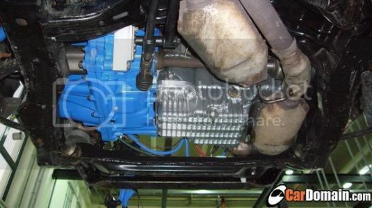

The intermediate shaft looks fine. Here's an example of a GREAT solution to the trans boss mount...
Enginelowerrear
I think you just wanted some of to be jealous of the underneath of that car
well.....................
It worked on me
