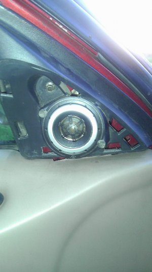

I've got a pair of Phoenix Gold RSD 6.0" components that I pulled from the 95. I yanked the sail panels off and pulled out the factory tweets. They're actually somewhat impressive...though I'd be more inclined to call them mids rather than tweeters as they are full cone with suspension. They're the same size as my computer speakers. Not the best idea for crisp, clear highs. For now, I'm sticking with the factory "bass blocker" that's wired inline in the factory harness. I haven't yet decided if I'm going to keep those or use the PG crossovers yet when I install the amp. I'll cross that bridge when I come to it.
I was fully prepared for some fabrication to make the tweeters fit. To my surprise, the fit was absolutely perfect. Screws weren't necessary, but I felt the need to use em anyway. Here's the finished product before I aimed the tweeters for proper imaging.
NTm5u
It's almost as if they were designed for the spot. The improvement in sound quality is already evident. Highs are much crisper now. Imaging needs some work, but the wife needed to be somewhere, so I'll have to fine tune tomorrow. Might even work on mounting the mids. I have an interesting idea concerning putting a round speaker in an oval hole.

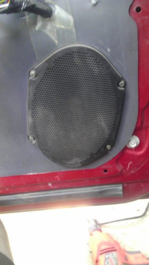

So our saga continues on the quest for eargasm producing sound. In part 1, we saw how easily a Phoenix Gold tweeter slipped ever so snugly in the factory tweeter spot. Now we'll see what happens when we install the 6" woofers into the doors.
First off, anyone who's played with a gen III sound system knows the speakers are all 6x8". The woofers I'm installing are 6". Hmmm...how's that gonna work since I didn't buy aftermarket adapters and have the fabrication skills of a fingerless lemur?
First, with regards to Mr Will Smith, old and busted:
HN9zph

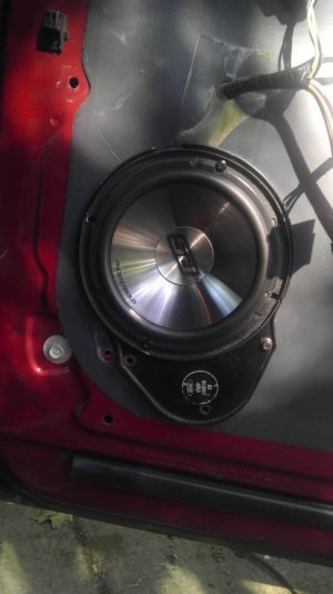

With the paper-coned wonder successfully pried from the door, we can now get down to business. After some brain-storming, an idea struck. I didn't need to buy or make adapters after all....I already had some that simply needed a little modification to fit.

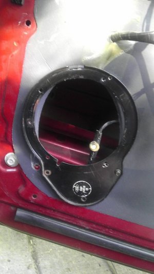

L2YC6h
That's a gen II speaker mount with one tab lopped off. It ain't perfect, but it'll do for now.

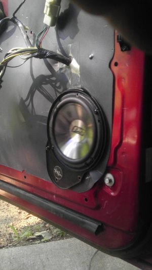

One new hole later, and I present to you the new hotness
J5O0ih
