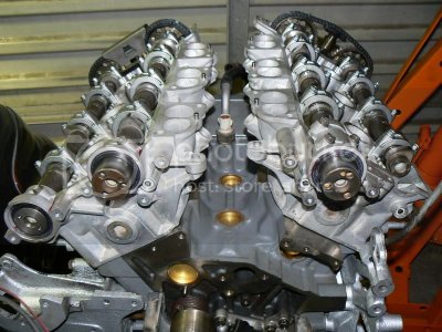

I wouldn't worry about the rings at all... It's definately time for valve stem seals tho.. my car never smoked, but it looked like they should have been when I took my motor apart. Blocks are solid in these cars, heads are iffy I would say if you know it got hot... I wonder if there are "heat tabs" on these? Never noticed one... Mains.. not so much to worry about... rod bearings? when in doubt.. swap em out.. ;)
Depends on the shops around there... but I got a 3 angle valve job done, they checked my clearances, and replaced my seals for $250... came out nice out of the steam cleaner... Best money I ever spent.. didn't have to worry about scratching the heads when removing the gasket, plus the car runs like a ***** ape now buddy.. ;)
This is what $250 got me...
P1000503
Good luck...
