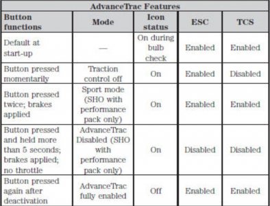

Can I get some help understanding ideal settings for 1/4 mile or light racing someone? So the chart below shows all the traction control settings based on button options.... as well as Sport mode on the transmission gear S - selector. I was under the impression for 1/4 mile you want possibly different setting say you are power breaking for boost. Was that RPM 2K btw?
If you are out and someone nods to a run, what do you do on your PP SHO is it different than a 1/4 mile option?

Traction control = wheel spin and will reduce power to stop the spin.
Advance Trac = if the car starts to slide to the side will try to straiten it back to center by applying brakes at certain wheels.
I turn it all off with the 2 fast tapping the TC button.
Use S or leave in D?

I just run D on the 1/4. S if roll race, bring it to rpm your looking for by the paddles and let the car shift up after planting the gas. As for brake boost 2k to 2400.
