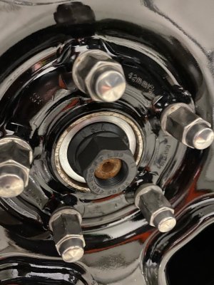

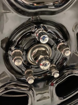

I know this is an old post but was looking for options too... I was hoping I could find a spindle cap /dust cap to just cover up that 2.5” center in the wheel... no luck so I had to throw something together...

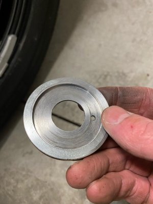

I used a 2.5” fender washer turned down to 2.25”, bored open to about .875”- put that in the hole then used a semi truck lug nut (same thread as my spindle) and put lug nut cover over the top of that... turned out ok..ish...

Might have to powder coat a set of the caps and washers... and different lug nuts...
