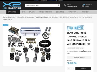

X2 industries does an air bag kit as an option for both ride quality and performance and yellowspeed racing does a big brake kit for the xsport which will fit our platform
Awesome! I would love some big brakes for my SHO. But once on their site, I don't see a pull-down for our cars—which model is the "XSport" from?
Woah! That looks very nice! My Marauder came with adjustable rear air-suspension from the factory. I wonder where this tank is supposed to go?
