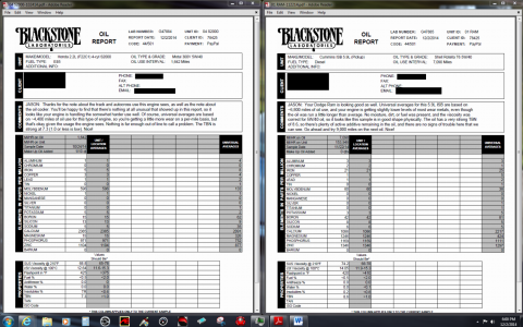

If you're using regular RP, it shears... badly. Get one of these on your next RP oil change and make an educated decision next time. :)

I know what you stated above; I was trying to urge you to educate yourself on said oil.
Just understand that you'll be running a thin 20w oil in about 500 miles. A couple of hot turbochargers will do a number on a resource conserving oil. Even regular oil will give you zero issues, but the amount of wear you see and longevity you get out of the OCI will be drastically different. If it's just a DD, you might as well find the cheapest oil that meets spec and have zero issues.
