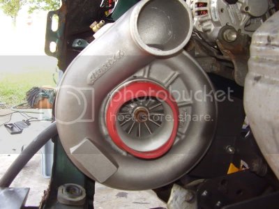

is there anyone else here on this forum that has a supercharged sho beside me or has experience with one? ive got a couple of questions and need a lil help if ya live in northeast florida.

yeah, ok i just really need to tune the car, cant afford tweecer, so if anyone in northeast florida or around there has a tweecer and knows how to use it. id appreciate the help, if not the whomever buys the car has to tune it

There are people in your area who coud tune the car. What are your issues? What are your fuel upgrades and how are you monitoring A/F ?

There are some shops in your area that do dyno tuning, and I know of at least one person with a TwEECer. Before anything, you're going to need some way to get more fuel into the engine because the stock stuff isn't going to cut it.

i dont think you have seen my car unless you saw it on craigs list. but i did do a completely different supercharger application than every other supercharged sho out there because of the unit itself was so large

the fuel system is not upgraded yet, i dont think im gonna do it because its forsale unless i get a great deal on the pump and injectors. i did the math and i need at least 35lb to 38lb ones and a modded fuel rail. pump is only gonna set me back 80bucks.

A supercharged sho with no fuel upgrades or tuning is a bad story just waiting to happen.

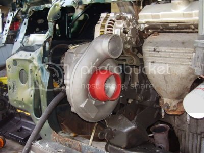

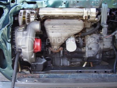

im gonna get the pics as soon as i can, ill give my dad or brother a call to do take em. im sorry about the wait for them. askin $5000 for it. if interested pm me.

I remember when you were PM'ing me on MySpace... I have yet to see a finished picture of the SC setup... Is it even finished? I aske because stock fuel isn't going to hand 10 PSI, stock timing would absolutely make pieces out of the pistons, and that SC looks to be on the small side.

If you're not going to run the AC compressor, you should make a brace to bolt back to the engine bracket. If not, that bracket will break. The AC compressor is a structural component for that bracket.
