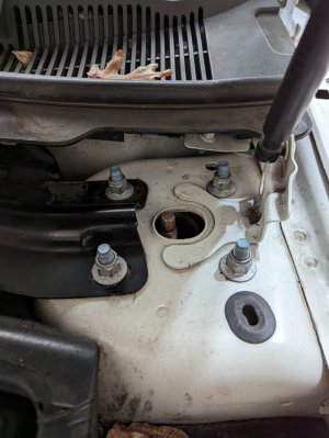

Strut top bolt not centered in tower hole
VwCSilent
Aug 9, 2018
25
FREDERICKSBURG, VA
2015 sho hr springs. Had it aligned and alignment is good. Problem is the car feels "loose" for lack of a better term. I've seen it described as tramlining. The only thing I've come up with so far is that the strut top is not centered in the hole. I'm not sure if this is normal since the car is lowered or if it's an issue. Everything else feels tight in the front end. Tires not wearing funny as far as I can tell.
The other side is equally pushed toward the inside of the car.
Thanks for any insight.

Stock wheel & tire size? Or after market and wider? Wider wheels and tires can cause this effect.
On my 2015, if I don't run 38-40psi in my tires I get the trampling a bit. (Stock wheels w/ 255/45/20's with a proper alignment) Car is a little billowy at the lower psi and wonders.

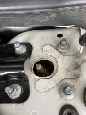

That is the stock size. Who did the alignment and when?
Could be the alignment is close enough per the "factory" specs, but not good enough to perform properly.
Picture of the drives side front. Not centered.

If you have checked the tie rods and control arms for movement, I'd also check to see if the wheel bearings are tight. Front and rear.
VwCSilent
Aug 9, 2018
25
FREDERICKSBURG, VA
Thanks for the info. Funny enough I am doing the front wheel bearings this weekend. They felt like they might have a little slop in them and they might have a slight hum to them. Car has 125k on it so I'm in the ballpark for replacement. At this point I'll hope after that it drives right again.
