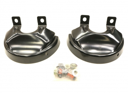

I wondered what the part looked like. For anyone else wondering,

shows the fitment as 1992-1998 Taurus and Sable. All trim levels seem to be included. Interestingly, Windstar isn't mentioned. The eBay seller may have gotten fitment completely wrong. That isn't anything new. Even Rock Auto occasionally gets SHO fitment information wrong - probably because they get vague or incorrect information from the part manufacturer.

My Gen 1 isn't part of the fitment list, so I haven't seen it either. It is billed as a "kit" which might mean it was part of a service advisory that could be added by the service department to address a specific issue. I'm still trying to figure out where they fit. I agree that it probably has something to do with the suspension, but I can't imagine if they are for the front or back.

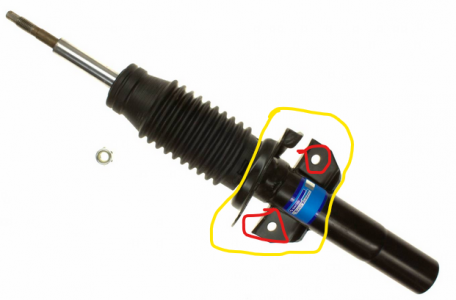

My best guess is that this is a shield to prevent a broken spring from puncturing a tire. IIRC, there was a problem with corrosion and breaking springs in the northern states. It mounts to the to two holes circled in red and cups the bottom of the spring perch and the bottom coils of the spring.

Interesting. I've never seen those on any of the GenI-III either.
