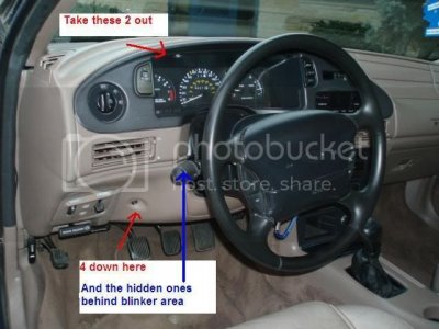

Take the 2 screws out that are on the top of the gauge cluster surround. And then take the steering column cover off(4 screws I think). And once thats off you will see 2 more screws on the left (behind blinker) and right of the column. Then grab a hold of the whole black piece (easiest to grab top above gauges) that holds the headlight, defrost, clock, drivers vents ect, and pull, it just kinda clips in. Once you get that pulled away you can get the headlight switch out, pull **** off, unscrew nut under ****, disconect clip, put new one in, put back together and hope its fixed
Edit here ya go
Steeringwheel2
WOW old pic glad I put the black interior in :evilgrin:
