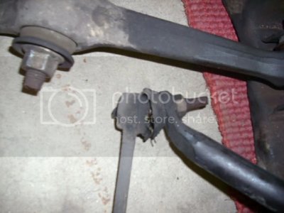

Just in from disassembly... I really have a ton of respect for you guys that can do all the great mods & maintenance on these (or any) cars. It aint easy!
The good news is the sub-frame is out. Engine hanging O.K. and I was able to remove all the fasteners w/o any breaking.
I'll post a few pics later with some questions on what y'all recommend for solutions.

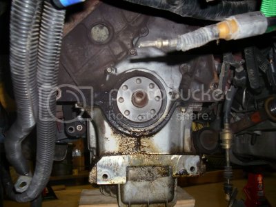

Rear main seal and carrier gasket are shot and need replacing.
Good luck.
Good luck.
Ya, both were ordered last week & on the way! I don't think I'll change the rod bearings since only 71,000 miles on it. Will do them when the 120k service comes up.

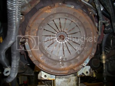

Uh-oh... dumb me. Over a month or so ago I ordered a "closeout stock clutch" from rockauto which is 9 1/4" thinking the car was still on it's original clutch. (it was only about $70) I was wrong & it has a 9 3/4" clutch. (that doesn't look too bad btw) I'm guessing I'll need to now spend a least a few hundred more for a better clutch set. oh well... live & learn!
I'd do the rod bearings now.
There have been instances where the bearings have let go at 70,000 miles. It's cheap insurance, and only an additional 90 minutes to do the bearings.
I agree, bought my 93 with 177k. Guy I bought it from said all maint. had been done. Decided to check since i had to reseal the oil pan anyhow and whatdya know?! Worn to h3ll and couldn't tell if they had ever been replaced or not.
