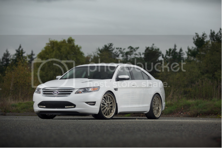

Here are a couple of pictures from when the H&R car had 22" wheels on it... I think it looks pretty good IMO.

that car looks awesome with those wheels, makes the gigantic car look normal sized :p
