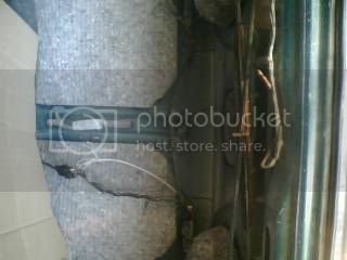

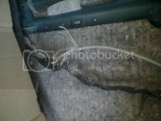

Alright. thanks!! Alltho mine didnt have a visiable amp.. heres what the trunk of the 93 has...
(rotate it 90 degrees to the left...)

First off, SHOs (taurii in general) are acoustical marvels. They can make an otherwise decent sounding system sound beyond awesome. But here's the source of your cofusion...
Stock system was designed to make noise. It's highs aren't as crisp and it's lows aren't as deep as anything aftermarket (unless you're REAL low on the aftermarket food chain). It's a decent all around system, but for anyone with ears who's looking to get good sound, you're not really gonna get it with the stock setup. Granted, your lack of sub in the JBL equipped car definitely isn't helping, but even with the sub in, you wouldn't have earth-shattering, eardrum bursting bass. The reason why your 93 sounds so much better is, even though it's low end, the aftermarket head unit doesn't have the crossover levels the factory setup has. And chances are, even if it's a ************* deck, it's gonna be putting out more and cleaner power than the factory setup is. That cleaner power and lack of crossovers is certainly going to make a significant difference in sound quality.
