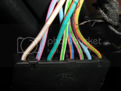

I broke down and decided to upgrade. But, and I stress but, I wanted to retain my factory amps and speakers. I attempted to use the speaker harness that is supposed to by-pass the amps. It didn't work so I used this part and now can use all the factory components.

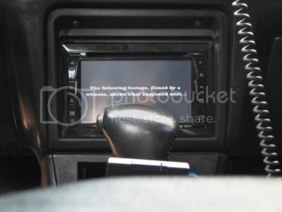

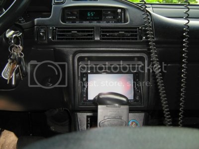

The stereo I chose was the DUAL XDVD from Walmart for $198.00. All I needed was the in-line adaptor and harness adaptor. The final look was impressive and all I had to do was cut the cross bar that separates the radio and CD player. I think it looks and sounds great. I hope this helps anyone on the fence about this topic.

Let me know what you think. The hardest part was getting the trim out.

Looks like a worthwhile upgrade :thumb: May do something similar myself someday, what with the cassette player on the fritz.

I'm trying to hook my aftermarket head unit up to my factory amps and speakers but have not had any luck thus far. I have got sound but is sounds horrible. What part are you referring to?

I simply connected my head unit to stock wiring with an adapter to the head unit, got the adapter from wal mart. Works like a charm and sounds awesome!

The Blue Thing in the 3rd picture:Scosche SLC4 Speaker Level Converter - $18.00 Walmart.
You simply screw the speakers out from the Stereo head (which should be already attached to the Metra Ford adaptor) to the 8 "in" slots on the top of the adaptor. Then you use the 8 "out" lower slots that go into the harness adaptor to the thick gray amp cable.
If you are trying to use a radio with an internal amp, it will interfere with the JBL amps and sound like ****.
If your unsure what I'm saying, let me know and I will post more detailed pictures.

did you use any other trim adapter?
does it fit firmly? how were you able to make it fit in place and not move/slide out?

No adapter, all I needed was the wire harness. Very snug, trim plate easy to take off then it slides out with harness keys that came with the radio
