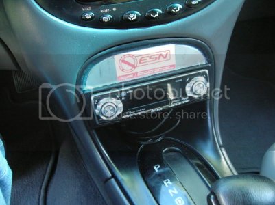

Read up some more, it's what I did. Works well... my work to show:
Don't mind the ****** sanding job on the fiberglass, I had to get that done in less than 3 days.
