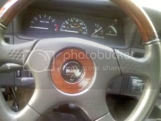

i want to go with a nice wood grain wheel one of these days.....
gotta **** out the Taurus a lil bit, plus I haven't seen a Taurus with that type of wheel... steal my idea before I get it done and I'll **** u!
something like this
or
classic_wood_gold
or
anni50
quikSHOilver
Yamahaized
Mar 8, 2004
380
205
Indy
I guess the 87-90 or whatver mustang momo hub adapter works for the Taurus.
DAMN! Now that's one of few cleanest 'N sharpest instrument cluster and S'wheel I seen! Nice!! hats off to you!
About the 3 gauge how did u set it up there , custom made or someone made it?:thumb:

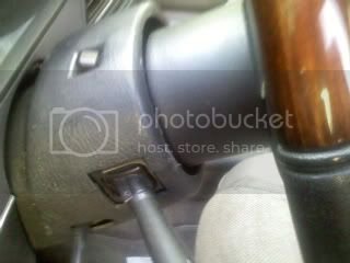

im going to take my wheel off this weekend and see whats going on in there. then i'm thinking of just fabing my own adapter to fit a grant steering wheel to my 89. hope i'm not getting into something more than i'm expecting. guess i'll do all the R&D, take pictures and report back. if its easy i will be offering the adapter to anyone who would like one. as finding an 89 adapter is next to impossible i've gathered.:salute:
