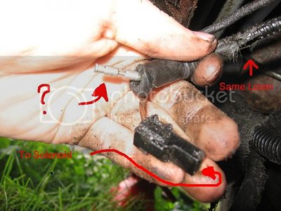

Hey Guys,
I'm really frustrated...I just installed my new starter and thought I had it wired correctly. The positive is the one that "runs" into the actual starter motor through that braid right?
there is also a broke clip or something that well I think it might be important...
Wire
thanks for your help,
James

the newer solenoids have that clip re-made into a nut, but they usually come with a pigtail to convert it. There ought to be three connections on the starter: One with a metallic braid already connected to it that you shouldn't touch that nothing gets attached to, another empty one that gets the positive cable, and a small tab that the clip plugs onto. The ground cable goes onto the larger starter bolt where it attaches to the frame (drivers side)As far as the ? in your pic goes, i have no idea, i've never seen one. where does the other end of it go to? (how many wires in the loom, etc)
