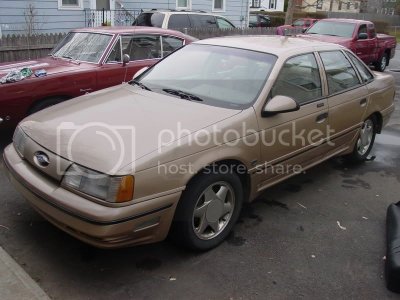

I know what u should do.... buy this beauty:p LOL.
I gave it a buff this weekend w/ heavy cut compound, then glaze flowed by a sealer wax came out pretty nice considering what it was

My jaw dropped to the floor, man. Hot $hit, I want my old car back!! Dammit! hahaha. Dude, if I had the money and time I would JUMP for that, believe me! Even if it was still flat and not polished I would. I depressed now :cry:
I'll trade you a somewhat dead 95 mtx for it! hahaha
