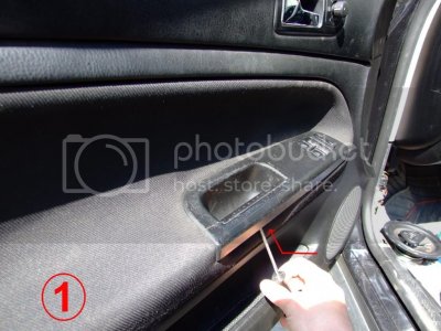

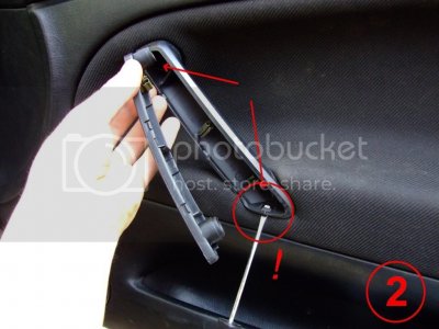

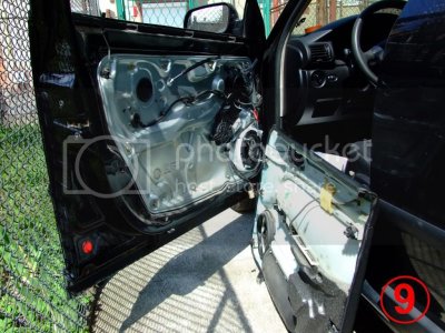

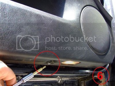

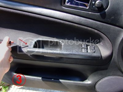

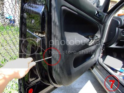

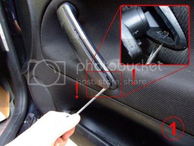

pretty sure the interior door pull has a plastic cover that has to come off to get at a pair of screws. those are the ones everyone always misses.
HotRodKid
mmmmm ... turbo
Jul 14, 2006
1,441
642
Western NY
Pull Handle for all but the drivers door:
Vw passat right dreapta spate ba 1
Vw passat right dreapta spate back

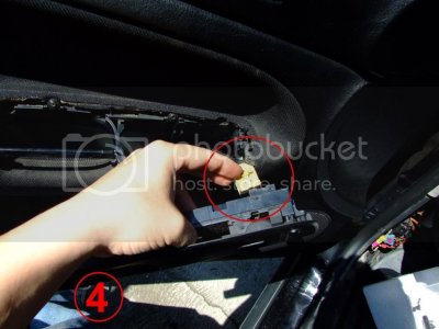

and full pictorial for the drivers door:
Vw passat left stanga driver doo 8
Vw passat left stanga driver doo 7
Vw passat left stanga driver doo 6
Vw passat left stanga driver doo 5
Vw passat left stanga driver doo 4
Vw passat left stanga driver doo 3
Vw passat left stanga driver doo 2
Vw passat left stanga driver doo 1
Vw passat left stanga driver door p
