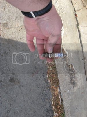

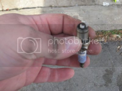

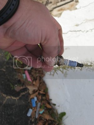

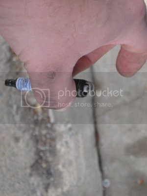

yeah well i got dealer plug on mine like about 2 month ago
and it run bad ive checked my plug 4 are agsp32fm and 2 agsp 32pp
why they gave me 2 different plug number ????
would those 2 make the car run weird?
i call the dealer and told me they will replace the 2 pp plug
but ive read people here put 32pp plug im getting confused
plus the plug looked like that
IMG 5606
IMG 5608
IMG 5609
IMG 5610
here you go you be the judge
they have about 15 000 km
so they are still not used enough
but i just wonder the pp where already gapped at 39 instead off 42 hummm
i guess tomorrow ill have 32 fm in there all around
but need some info just to be sure

i would buy a set of autolite dbbl platinums. they work great in the SHO's. i had some and it idled very smooth. recommended. they are pretty cheap.

well i put in all around new 32fm plug so ill see even do on my original stickler in the car im supposed to have as original 32pp plug
