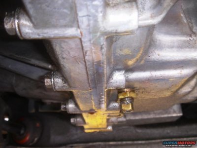

You have to drill and tap the case - the 1/8 npt pipe plug can be found at Lowes or Home Depot. Finding a single 1/8" NPT tap is harder, so far I've only found it in sets.
I used the Timkin input shaft seal. I didn't change the shift shaft seal, since it didn't leak, and can be done with the trans in the car. I also wasn't sure how to get it out, lol.

I installed a drain plug in my transmission during my last rebuild. I used a brass plug I picked up from Home Depot.
Dsc01565
This way I leave the part that goes into the transmission alone. When you drill the hole, go slowly because the aluminum is soft and galls easily.
