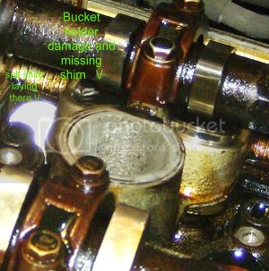

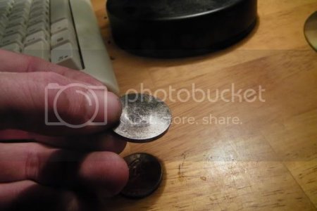

That sounds absolutely the same as my 93 that spit out a shim.
I first noticed something wrong when I would start the car and it sounded JUST LIKE THAT...but I would let it warm up and it would clear up and smooth out. What I was noticing is that's how it sounded when a valve was stuck open but this shim was still there in it's bucket. After several seconds, the valve would loosen up and all would be well.
My real problems started when the valve decided to pop closed while there was no cam lobe there to keep it in place.
HPIM0741
It's definitely mechanical. Don't bother trying to troubleshoot anything electrical. You need to get that valve cover off and inspect every cam lobe, every bucket, every shim.

Found it!
100 2891
100 2892
Shim in the exhaust side of the cylinder jumped out, I inspected the shim, the top of the valve, and the lobe, everything is clean as a whistle, a lot of relief after finding the shim just laying there.
100 2890
All the fuss over this thing. 93rev2sev you were completely right from the get go, the injectors were a problem and threw a wrench in tracking this down quicker but it was an ejected shim.
Ok, so bare with me, I can't explain how relieving it is to see no damage from the issue.
As for fixing this, is it not reasonable to just turn the cam and baby the shim back where it needs to be? Wouldn't it just be like what your doing 23 more times in a valve lash?
EDIT: I turned the engine over and the valve itself seems to be stuck open, I tapped it lightly with no luck, looks like I'm going to have to pull the head... No celebration quite yet after all..
EDIT: Had my dad turn the engine over while I watched the valves, it goes down when the lobe touches it but doesn't come all the way up, essentially sticking halfway through it's motion, I dont' hear the piston touching it which is good.
What am I looking at here? A broken guide? Broken spring? Or just a carbon build up ?
