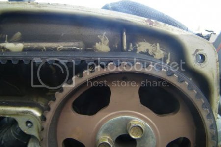

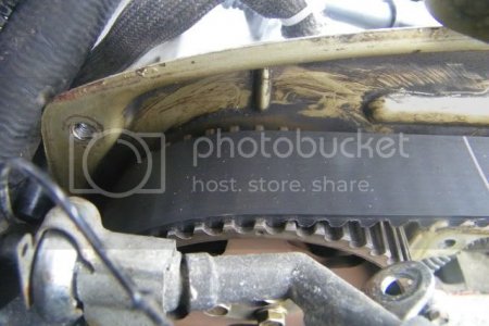

I was thinking on it, as long as the indent on the cam sprocket lines up with the line on the back of the cover?
I'll go get some better pics for you, gimme two minutes..
EDIT:
Here our face on shots, the teeth are were they are supposed to be as far as I can tell.
100 2841
100 2842
Does knowing that cylinders 1,3,4,5,6 are fouling their plugs help me diagnostically at all?
