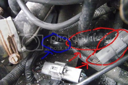

I[ B] have[/B] isolated the source of the voltage problem,
I took some pics for you guys:
100 2852
These two connectors (in red) go into the injector harness. The blue circle is a massive 5 way intersection where the problem probably is.
Note the electrical tape on the black connector.... It looks darker and newer then the rest of the harness, it this possibly the evidence of someone's (not so) handy work ?

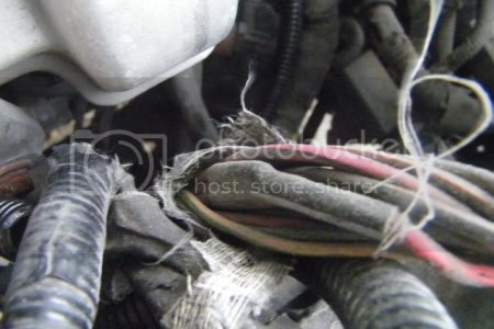

Here's the red wire in question,
100 2854

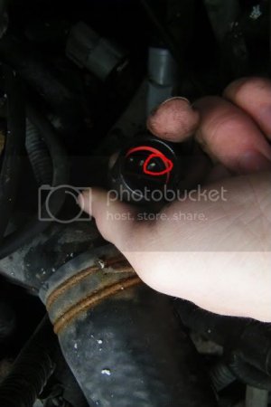

And then pin itself, which after two checks read out 3.56v
100 2855
Now seeing the newer and not so factory looking wrap on the black connector I'm guessing somewhere along the way someone was inside that harness and botched something somewhere eventually leading to the sudden short and hence forth a multitude of the injectors simply stop opening/closing.

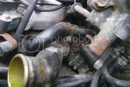

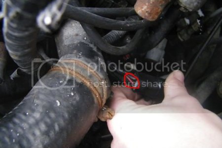

After already starting to wire a new wire to the red wire on the black connector I realized that it was actually red w/ a black stripe. So out of blind luck turns out the splice was pretty darn close to the CCRM.
It's a three way splice, so what is the 3rd wire going to?? 100 2859
I haven't checked the wires after the splice for voltage yet, I spent a frustratingly long time fighting a rusty clamp that impeding me from taking the thermostat housing off (to allow easy access to the harness).
Clamp in question...
100 2856
Tomorrow is day #5. Hoping to get some sound results...
