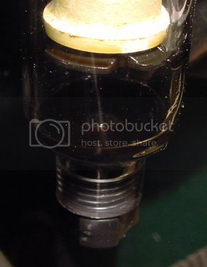

I have a small Parker pneumatic oil coalescing trap in the PCV suction line on my SVT Contour, it has to be emptied about every two tanks of gas. Coalescing traps will catch oil vapor and moisture, but you have to size them right, if they're too (physically) large for the flow rate, they won't be effective.
DSC02244
250 miles later.
Crop of Oil sep with oil 250 miles
