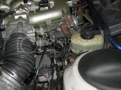

Found the leak, it's in a PITA spot to get to, so I'm hoping you guys will have some tips to make this easier. The white circle, maybe hard to see, but that's the hose that is leaking (the one with the metal fitting). Here are the pics:

Read this thread - http://www.shoforum.com/showthread.php?t=78334
That line isn't available new, but posts 6-8 in that thread explain how to fix the one you have.
Ok, so I need to remove the hose from the block and at the little metal crimp on the hard line, and replace it with the hose shown in the posted thread? The problem I am having right now is getting the hose off the block. The hose clamp is positioned to where I cannot get a screwdriver or socket on it. could I just pull it off with vice grips?
Yup. Just be careful not to damage the pipe underneath the crimp.
It's gonna be tough to remove unless the clamp is loosened somehow. If you want, you could cut it with a Dremel or something and then remove the hose. You'll obviously need a new hose clamp if you decide to do that, but you'll need a new one for the other end anyway.

That is a PIA to get at. You can try and get to it better by taking off the MAF and the trottle linkage and pulling every thing back out of your way using zip ties . Worst case is you will have to take it to a radiator shop and have them do it. Should not cost much. If the car needs the top end maintance done ie if you have oil in the plug wells then you need new plugs, cam seals, plug wires and gaskets, you might want to just do that now as if you take the intake completely off, you can get to the hoses a lot easier.

Got the hose off and a nice puddle of coolant in the garage ha ha! Well now for my next question, do I need to take that entire assembly out to fix the problem (hard lines, sensor, hoses to fire wall)? I highly doubt my hacksaw is going to fit in that tiny little space I could barely fit my hand in.

Well, it's still not off! I've broken two hack saw blades and not there yet! I honestly don't know what to do at this point.
