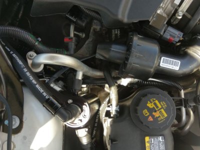

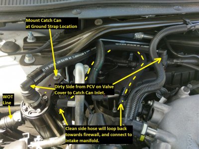

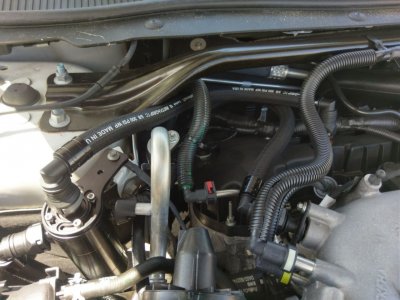

did you install the sho specific application? if so i would talk with upr directly. how much oil you catch is a function of proper connections of course but also the location of the can itself. the lower and cooler the better. you will see more results in the winter time as conditions are ripe.
would also advise making sure the hoses are fuel/oil rated. many have had a problem even with hoses supplied by the catch can manufacturer.
@kryptto you have a upr setup correct?

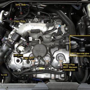

Yes sorry been dealing with this sheet in airports:
Here are my photos, https://photos.app.goo.gl/PYiuL7BeGHCJbVabA
I have the same model year, so photos should natch, the 2015+ have a different strut tower config as a fyi.
If there is any questions about parts and install contact Steve Buscius directly.

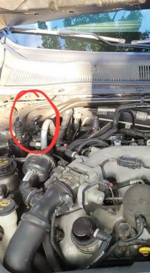

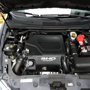

Sorry guys I was on vacation and didnt have time for the car. I took photo of how my catch can is connected and seem to be similar to your photos . I've seen guys saying that it could be that the turbo oil filter might get clogged. Do you think I should clean them ? I didnt have time to check the cranckcase pressure either.20240723 140346

Sorry guys I was on vacation and didnt have time for the car. I took photo of how my catch can is connected and seem to be similar to your photos . I've seen guys saying that it could be that the turbo oil filter might get clogged. Do you think I should clean them ? I didnt have time to check the cranckcase pressure either.View attachment 91322
View attachment 91324View attachment 91325View attachment 91326
That looks like mine for sure - you replace the filters in the turbo lines btw. They can be a pita to get out as with anything right engine turbo.
