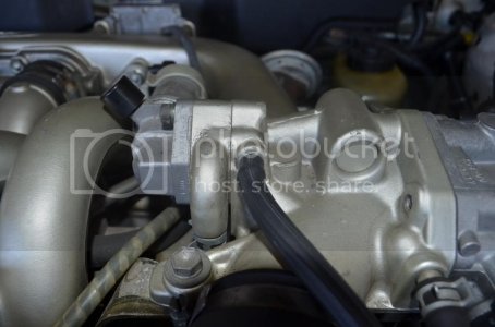

Hey guys I was just digging around my engine bay yesterday trying to find a small coolant leak that I have had for awhile. I found this hose was wet and spongy (the top one) and connector (probably wet from the hose).DSC 0035 zps3cc68513
So I traced the top hose up the motor and determined it was this hose.
DSC 0032 zps27dab33c
SO, what is this hose? I'm sure that its not the only thing that was leaking, because i found coolant on the bottom of the horns and abs pump AND i have yet to rent a pressure tester from Autozone, but I was going to replace it anyway. And was just curious what it is for. I can't even identify in my service manual! Haha

Thats not a coolant hose. Thats the hose that runs to your purge canister. It doesnt leak coolant because it doesnt have coolant in it. Keep looking for the leak.
Move the car to a different spot and put a large piece of cardboard under it then watch to see where the leak is coming from by where it is dripping on the cardboard.

On another note, do any of you guys know what that little T connection is on the 1st pic? Its right behind the radiator, on the left side of the car (if your sitting in the drivers seat), and the hose was very soggy and left black on my glove when I touched it.
7,521
that T connector connects the gas vapor canister to the fuel tank and to the intake manifold. when the purge solenoid is open, it vents the vapor canister into the intake to keep it from getting saturated.
those vacuum lines all are soft and mushy after 20 years of constant exposure to gasoline and/or gasoline vapor. they are often sources of vacuum leaks and sources of fuel smells under the hood.
