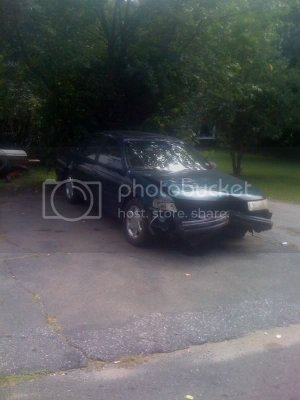

Hard to say without under hood pics, but good for you for wanting to fix that and keep it on the road.
Sep 6, 2002
2,351
Westerly, RI
It doesn't look *too* bad, but like the others said, underhood is the only way you'll know for sure.
Weird things happen with hits like that, especially on these Northeast cars that may have rust. Check the frame horns (where the bumper support mounts) to make sure they're not bent. If they are, it's gonna have to see a frame machine and may not be worth the cost.
Depending on the price and condition of the rest of the car, it's at least a good parts car.

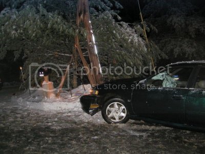

what do you guys think?
Hmmm why does that look familiar......
Oh yeah! Now I remember!
I tied the car to a tree and backed up in order to pull the radiator support out, "fixed" the cosmetic crap up, and drove it for quite a while after that. I put a lot of work into it, and that was only to make it driveable. It was a beater from that point on, though. It probably has two dozen zip-ties holding the front end together...
Edit: Are the airbags blown in the one you're looking at? From the pictures, I'd assume they are. That's another expense to consider.

air bags are not blown unless he replaced them but I doubt it. He said the car was basically mint before the accident it has around 120k on it with all options. It looks like your car has less damage but the bags blew.

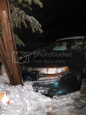

I find it hard to believe the bags didn't blow. There's a crash sensor in the middle of the radiator support, right where the impact occured. If they truly didn't, I wonder if they're even functional.
The impact on my car was further toward the passenger side. There was plenty of damage too, though it's hard to tell in the pictures I posted. I'll dig up some others.

I probably would've said the same thing before I splintered that pole... now, notsomuch.

yeah i looked it up on craigslist the only thing i would worrie about is if the subframe got damaged but the car looks good well besides the obvious does it run and drive?
x182dan
Feb 17, 2005
289
Seymour, CT
it runs but he said it leaks antifreeze quickly so he doesn't run it long. This car is literally 2mins from my work. I was gonna look at it tonight until the rains came hopefully I will look at it tomorrow. If its not worth fixing I still may get it for to part out.
