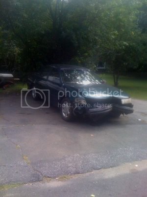

I am going to look at a 93 SHO with a wrecked front end(hit a tree). I haven't even looked at it yet but from what I see and what the seller says it needs front bumper, radiator, radiator support, all the lights are done, and the head panel. The 1/4s look fine from the picture but I can't tell. My question is can I swap everything over from a normal taurus? I know things are different like the bumper, headlights, header panel, etc. Say I have a 93 regular taurus with a good front clip can I just swap it over onto the 93 SHO? Depending how bad the radiator support is I might just pull it out and if I could do that I wanted to bolt the taurus header panel.

but whats not compatible? I'm talking everything. I don't plan on using any front end SHO parts because I want a cheap fix. What would prevent me from bolting it up?

^ Don't know where you got that info.
All SHO/SLO body parts are interchangeable. You can't have SLO lights with a SHO bumper (or vice versa), but if you have SLO lights and bumper, you should be fine. It'll look silly with the SHO body kit starting behind the wheels though.
Not much room between the engine and the radiator, if he busted the front up that badly you might want to check the engine for damage too. Check the front of the subframe where it bolts on as well.

As far as I know if you swap the SHO front clip with a SLO front clip it should work just fine. But you can't mix and match. If you use a SLO front clip everything has to be from a SLO and vice versa, except the hood.

ok thats all I needed to know guys. Thats what I thought but I just wanted to check. The damage is bad enough that the radiator is busted so I guess I won't know how bad it is until I get there.
