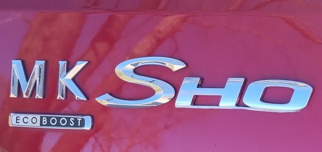

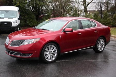

Well it's not a sho but it's pretty darn close. A 2016 Lincoln MKS with the twin turbo ecoboost engine, same as the sho. Only 31,000 miles!
