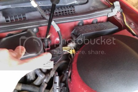

I had this exact issue check the wires on the black distribution block on the firewall on the drivers side. Mine were corroded and only a few wires were connceted and that was what caused the shutting off and immediately turning back on. Might be your problem as well..

Mine doesn't have that black box, mines 90 style. That wasn't till 92. The wiring seems ok, and the wire that turns on all the sensors and such is working fine.
