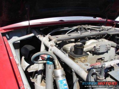

That looks like Lupo's (?) short course offroad SHO Ranger.
IIRC when I was working on the Ranger, I moved the tranny back on the crossmember around 1.5", to pull the engine back and give room for the crossmember near the oilpan.

There was a guy that won the Short Course Stadium Racing I think back in 97 or 98 that used a Mazda B3000 with a SHO motor in it. I think it was called PEP Racing. He told me that Mazda basically gave him the truck as long as he had it at various Dealer Grand Openings. Here is a pic.
Pep9
He ended up selling it to a Fireman in Tucson who ran it all over the Dunes of Southern California and then put it on Craigslist. I went down to Tucson to look at it to buy, but it had been run hard for so many years, it just didn't look like it had many miles left on it.
It is Lupo's and they use it in Jump contest's and it does quite well.
