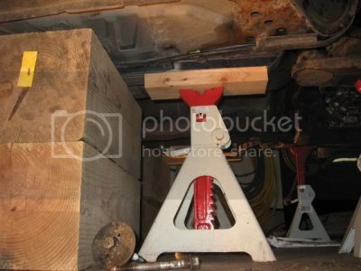

And another thing. When I do jack the car up, I put the jack stands on the frame. Is that a good place?
itwonder
Dec 17, 2005
1,909
556
VA
The jack can be placed on the subframe to lift the car, and the jack stands positioned on the frame like this. Large size stands should be used to be solid and safe. I place wood blocks behind the jack stands to be extra sure it can't fall on me even if the jack stand was to fail; belt and suspenders so to speak. Safety first! Be absolutely certain the car cannot fall.
IMG 1992Small
In the rear, the wheels can stay on, but it may be helpful to raise it slightly. A stack of two 2x12's under each wheel will lift it 3".

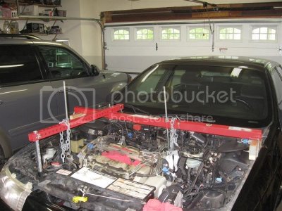

While we're at it, here's the engine brace set up. The rods hold the weight; the chains back up the rods for safety.
IMG 2000Medium

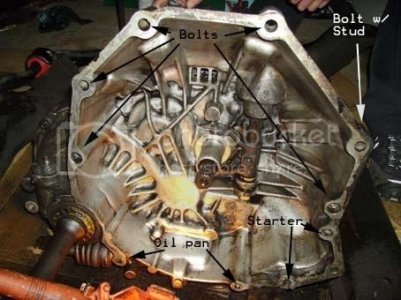

And here's a handy shot that shows all of the fasteners that secure the bell housing to the engine.
MTXboltpattern
