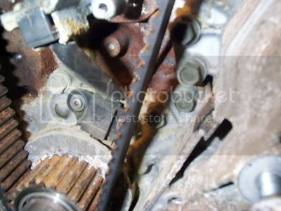

93rev2sev
Nov 1, 2004
6,461
1,825
Hockeytown
if you loosen the lower timing cover you can have a peek with a pen light at the arrowed location. If your timing belt STRIPPED you will see the cogs laying under the crank and some might even fall out when you separate the timing cover from the oil pump housing.
