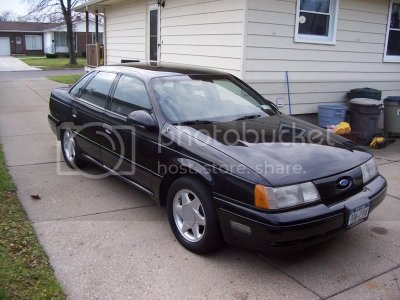

sho'd said:
holy shat, that is in really nice shape! who's car is that?
SmoknHondaOwnrs said:
:dribble: :dribble:
How much How much??
redSHO96 said:
i would love to drive to buffalo and buy that gen 1 thank you. would you like a gen 3 by any chance?? im not serious, i have absolutely no money for that but would love one. This guy is an internet friend that doesnt live in NY
its oe of the local sho guy's cars, donno if hes on here or if hes posted it on here
car is in amazing shape and hardly modded
its posted on www.nyspeed.com in the classifieds section, signing up and talking to him would be the most effective way to find out about the car / strike a deal for the car
