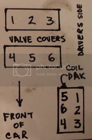

Ok i have another update. I now have the injectors firing after tracking down a loose ground, and i have managed to get a couple good backfires out of the motor but it still wont kick off. i have a led light hooked to the number one injector negative lead from the PCM and i can see it flashing now when i crank the motor. i have spark at the plugs. it seems there is some sort of timing issue but not sure now what it can be. any suggestions? if i disconnect the camshaft sensor the tach stops bouncing when i turn over the engine so i think the cam sensor is ok.

Check the spark plug firing order. It's very easy to get wrong on the SHO. This diagram is, of course, oriented for the stock transverse installation.
SHOsparkorder

swapped the wires stuck in a couple new plugs for some that were real rusty on top and started cranking. it sputtered then tried to fire, i went about 3/4 throttle and I be damn, it started. let it run for just a minute to clear it out as i have no water in it right now. have to replace a radiator hose and we should be good to go. appreciate the help.
