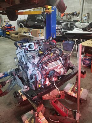

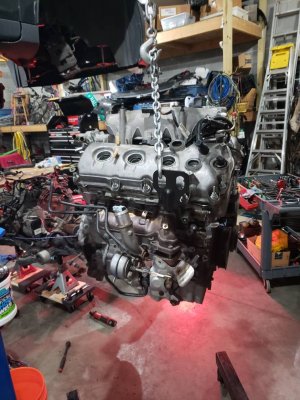

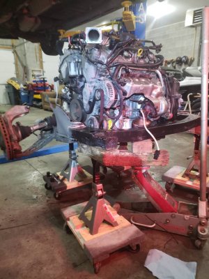

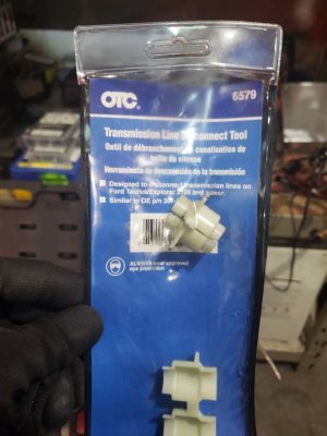

So I'm done with my 2011 so on to the 2010. Got the engine out in about 5 hours by myself. Looks like I may have 2 replacement turbos on this thing. Few tips, I used the otc trans line tools in the pic. They work great, push in the line hard, rotate the tool in and give it a little tap with a punch to seat it and yank the line back. I put the jack stands ondolly's, was tough to line up last time. This should help. I also use 4 different paint markers and index things with dots of the same color. Makes reassembly go faster. I have a donor 2013 engine im going to install. Lowering springs, new struts and im going to tune it with sct while keeping stock exhaust. Probably do the trans tsb also since it fixed my 11. The separator plate is $15 and it's a breeze with the cradle out.E179f424ae644c3edf9cae12bf78a1e4Ae62d3d3d225c52bf29deae6da2c41745896e6e355d629a7f6a38c0d4be900fc

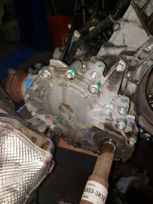

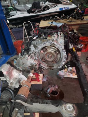

Separated the engine from trans. Different torque convert bolt pattern in this as compared to the 11 (it had 3 bolts). The tone ring on the flywheel is different along with the sensor. Also looks like my ptu has had some work done on it based on the colorful marks. 92c60adc2a80f0d70e9f7a9879f8160f28b4583797458be8383a82a56fdb494b482430690fcaeda6fc426505e5d7e36f
