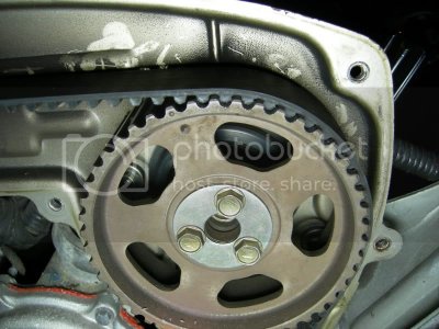

Now...the timing looks to be off; maybe I'm stupid but I'm learning. I haven't removed any cams. Here's a pic of what I have
60k2
60k3
The little dots on the sprocket don't line up with the line mark on the dust shield. I thought they were supposed to....and I haven't even removed anything yet in regard to the cams/sprockets.

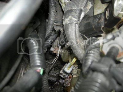

And finally, what I thought was p/s fluid all around the pump looks to be sludged oil, which means my damned rear cam seal must be leaking...ugh, what a PITA. Take a look
60k1
Crap, I'm wondering what else needs to be done while I'm this far in the car. I'm almost dumb enough to try to replace my noisy p/s pump. I'm sure the car will be down for awhile awaiting parts if I find more junk wrong.

Rotate the engine by hand a few times. If i remember right, every 3rd rotation of the engine will put the cam sprockets and crank in perfect alignment. Once the belt has been installed and the engine has been ran, the belt will never align perfectly again.
7,521
That timing belt looks almost new - it will not need to be replaced.
The timing belt sprocket marks only line up if the crank pulley is turned to the timing mark (and then only every 2 revolutions of the crank, since it is a 4 stroke engine), so all you need to do is rotate the crank to the proper location.
The timing belt lines only line up occasionally, due to the length of the belt vs. the # of teeth on the sprockets. Don't worry about that except when you are installing the belt.
