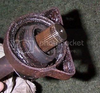

When you go to change your passenger side axle, you don't need to remove the intermediate shaft...therefore, you don't need to refill the transaxle. It might be the "right" place to start.
HOWEVER, the intermediate shaft HAS been known to cause the phantom shaking that we are hoping will be cured with axles.
Here's a pic of a prime candidate for the "shakes"
DCP01154
