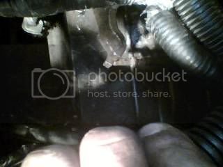

Ok, everything is going meh, until i hit the clutch.... And this is what i have to show for it...
The lever is sitting up WAY to high for the cable to slide in.. This is scaring me, i hope nothing is jamed in tranny. IF i take a pry bar to it and use the tranny to get leverage, i can disengage the clutch, but its tooo high. i think the lever its self is bent, and i dont know how to fix it without breaking something inside the tranny, and for that matter release the clutch to slide the cable on...

What do you mean "high"??? Your picture doesn't really tell much.
If the arm is too high off the top of the tranny case, then you may have broken off the lower half of the TOB fork or somehow the fork managed to come out from behind the TOB.
If by "high" you mean forward, you have to release tension off the cable by having someone pull up on the clutch pedal while you extend the cable and slide it into the arm. Or you can use a block of wood or a bungee to hold the pedal up while re-installing the cable alone.

It is too high up. I dont believe it came loose in the tranny because if i push it, it works just fine... IDK. Sorry about the pix. ill try that

Ha, wow i feel retarted... I pulled up on the pedal and it gave me MORE than enough room to slip it on.. HA thanks soo much Annon.... Now i just need to figure out how to fill it and i can start it!! :)
